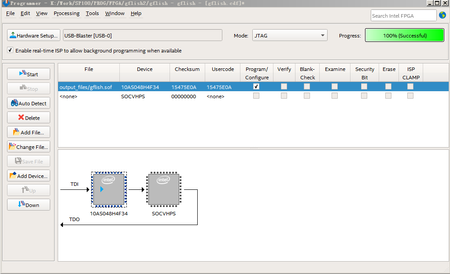

scong4Occasional Contributor6 years agoCan't read data from Arria10 , I can write program to Arria10 , but can't read data from it . I can only check "Programe/Configure", how can I check others ? Show More
sstrellSuper Contributor6 years agoThe other options are only for CPLD/flash based devices. You can't use them with FPGAs.#iwork4intel
