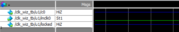

I'm trying to simulate Altpll IP using ModelSim. Even tho I mapped the library to the work location, I still see Hi-Z signals on Waveform.

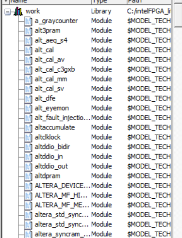

Here's the steps I have followed:
1) Change Directory to where my source files exist.
2) Map to library. I chose the path of altera_mf library and mapped it to the work.
3) Refresh library, compile and simulate.

    I try without problem check screenshot attached. Attached the testbench for your reference. In modelsim, make sure click the zoom full option.
