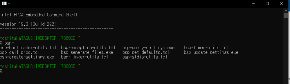

If you preferred the bsp-editor GUI, please proceed to use the 19.1 version of SoC EDS. The bsp-editor GUI is removed in 19.3.

Starting from SoC EDS Pro version 19.3 and SoC EDS Standard version 19.1;
Our Stratix 10 SoC and Agilex does not use SoC EDS bsp-editor . However, the bootloader generator(bsp-editor) is still used for Cyclone V and Arria 10 and the steps to build are available below:

But bsp-editor was not found on both cases. When I try to find bsp- related tools in the shell by a command completion with Tab key, I got this result:
Othe bsp- related CUI tools are seem to be installed.
I'm using Arria 10. Because the manufacturer of my board recommend using bsp-editor in a reference design document, I prefer to use bsp-editor.exe, not the CUI tools described in that rocketboards wiki URL.
