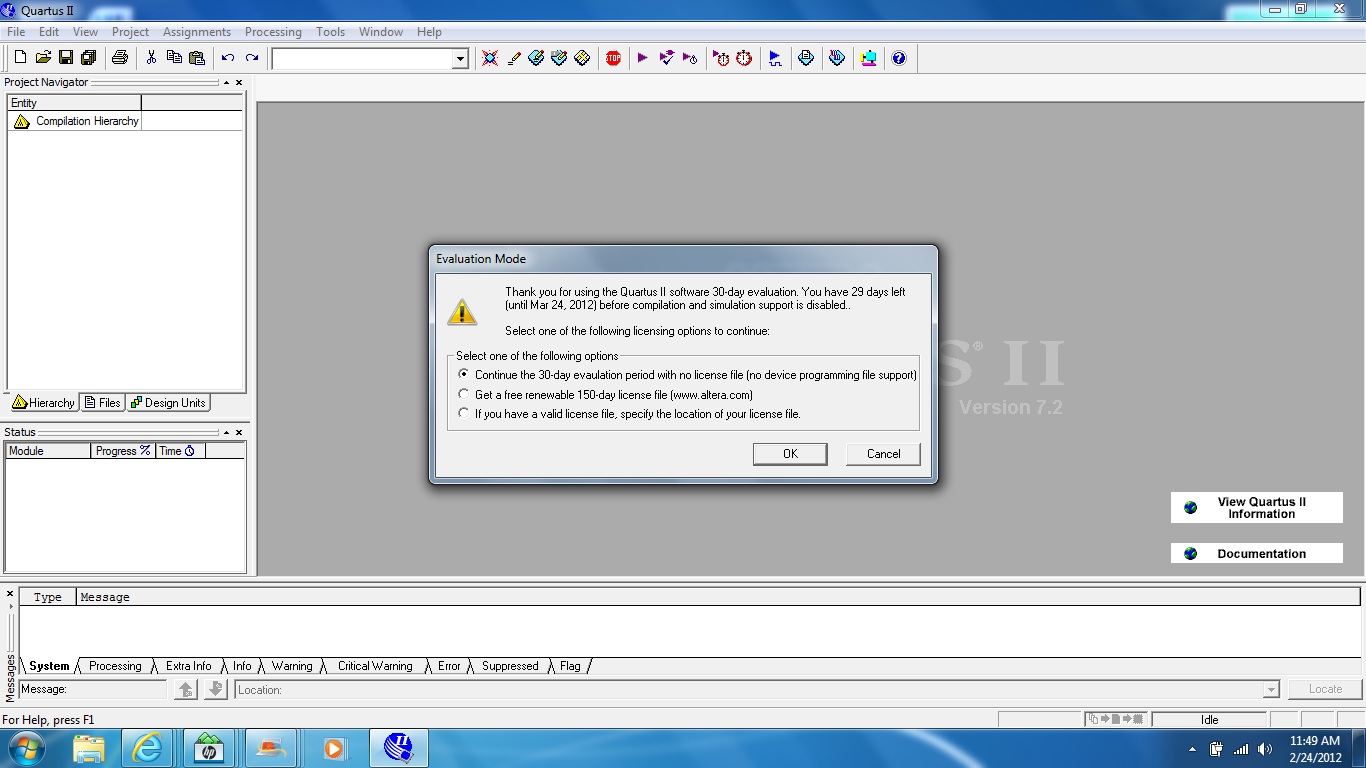

I installed the "Web Based" free Quartus II design software on my Windows 7 operating system. When I started the Quartus software, it asked me three questions about using the software...get a license for 150 days, continue 30 day evaluation, add a license file ???? I thought the web version was free ? Also, the tutorials for DE1 didn't seem to answer what was the correct answer.

    i haven't seen the get a license for 150 days message. could you post a screen shot?

    The 150 day option takes me to an Altera web site, with instructions to find my internet address ?

    You are apparently installing an old Quartus version. It's assuming the old Web Edition license scheme. The old version should work for Cyclone II and DE-1. Alternatively you can download recent Quartus V11.1.
