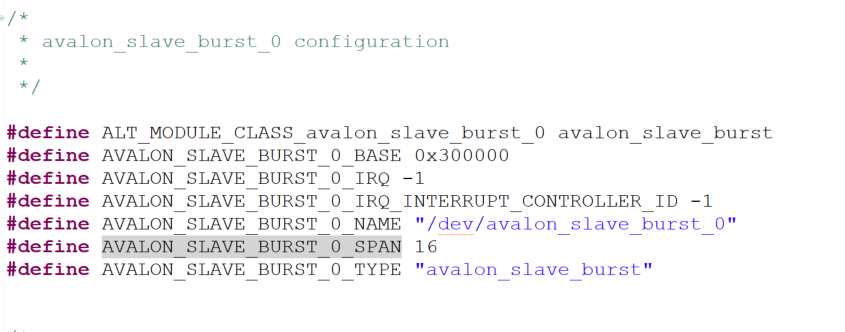

I am transferring data from Nios (master) to the FPGA fabric (slave) through the Avalon-MM interface. How do I set the burstcount parameter on Nios and initiate a burst transfer?
I don't see any flag/API in system.h that will help set the burst count.
