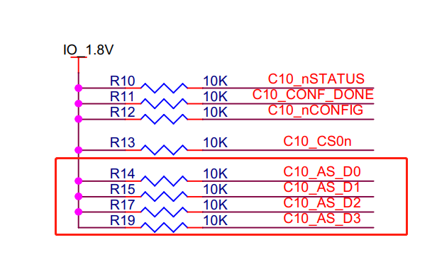

AS mode Configuration Failed
Dear Sir/Madam
If 10K pull-up resistance of ASDO /DATA1/DATA2 is necessary in as configuration mode​?
  • TGao's avatar
    TGao
    I use 8.7k Ω resistor instead of 10K Ω to pull up, but I still can't configure as correctly
    Ted.Gao​
  • Hi,
    It is recommended to used 10K Ω per Intel recommendation as we succeed the test at 10K.
    Thank you.
    Aiman
