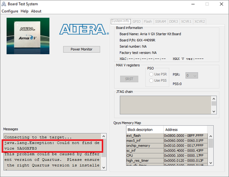

6 years agoArria V Development Kit... Has *anybody* ever got the "Board Test System" to work, being that it comes default looking for a "5AGGXFB3" FPGA. Seems that the actual DevKit comes with a "5AGXFB3" (only one "G"). Makes it hard to use.

6 years agoHello,
Welcome to INTEL forum. Could you help verify the Switch and Jumper Settings are in default factory switch settings for the Intel Arria V GX FPGA Development Kit and try the BTS test again.
You can refer here https://www.intel.com/content/dam/www/programmable/us/en/pdfs/literature/ug/ug_avgx_fpga_dev_kit.pdf#page=16
