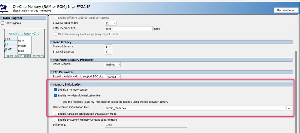

Hi
I believe you have generated a hex file from the step below:
https://www.intel.com/content/www/us/en/docs/programmable/683689/current/application-12184.html
After generating the hex did you select the hex as the initialization file for the on chip memory?

- tehjingy_Altera
Hi
