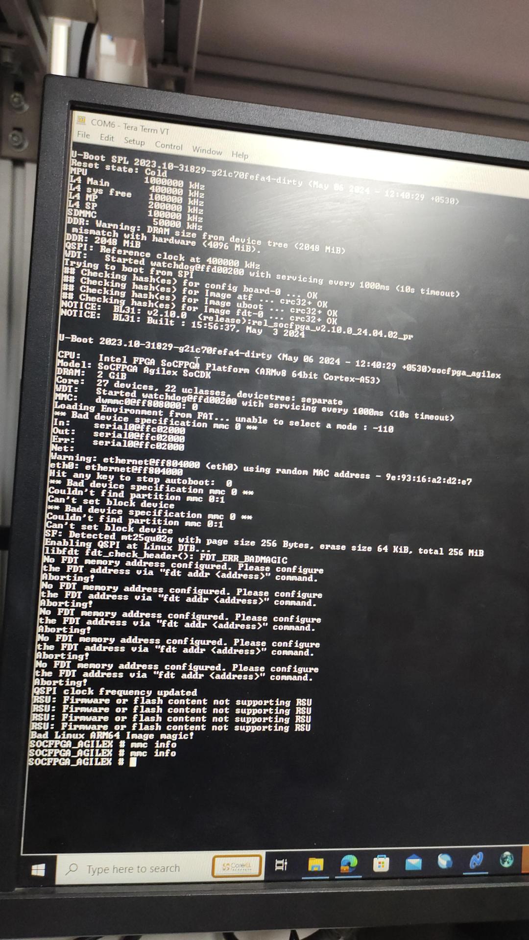

We are using the F Series Agilex 7 SoC for our custom board and have encountered an issue with the eMMC flash used as our boot device.
Recently, the eMMC flash became corrupted, prompting us to retry with previously working files.
Initially, the eMMC was not detectable with the default bus width of 8.
After changing the bus width to 4, we were able to detect the eMMC.
however, we are now facing issues with booting Linux.
Please find the attached logs for your reference.
We would appreciate your support in debugging this issue.
If you need any additional information, please let us know.
Attached logs and images for reference.
