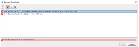

I’ve reviewed the documents and followed everything according to the documentation.
As I mentioned in my previous message – the system sees the device and has theoretically negotiated the link. Below is also a screenshot from SignalTap:
I'm also including the "Event Counter" tab from the console:
To be honest, I’m not sure where the issue is.
