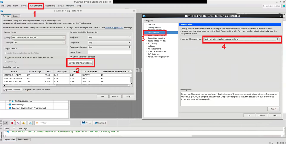

    Hi JW1121,
    Have you tried to set the unused pins to tri-stated in Quartus?
    Please refer to the following picture (go to Assignment --> Device..)
