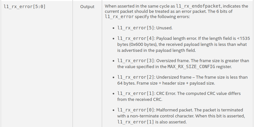

I tested with QSFP Port 0 and 1 at 10G mode, and always received RX_MAC error, i.e. l1_rx_error = 0x3 or 0x4

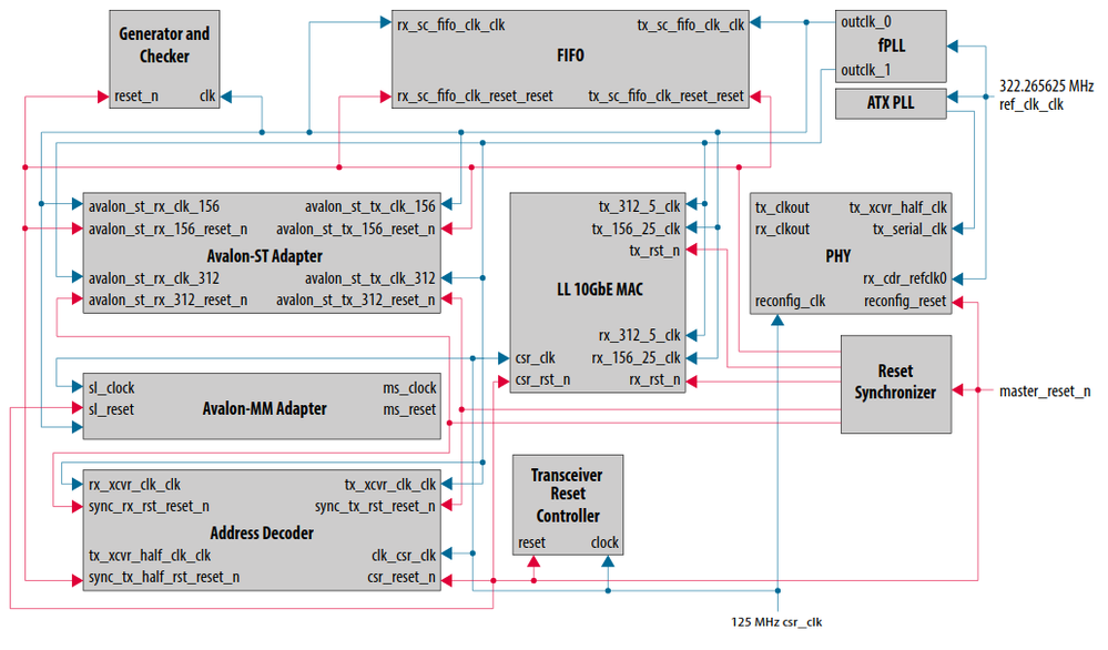

I followed the Low Latency Ethernet 10G MAC Intel Stratix 10 FPGA IP Design Example User Guide
My implementation steps:
1) Generate the example design Low Latency Ethernet 10G
2) Change the top-level, QSF, and SDC files corresponding to the S10MX board (using the golden example file from HERE)

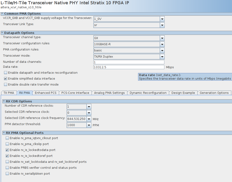

3) Change the ref_clk_clk to 644.5312 MHz. Then reconfigure

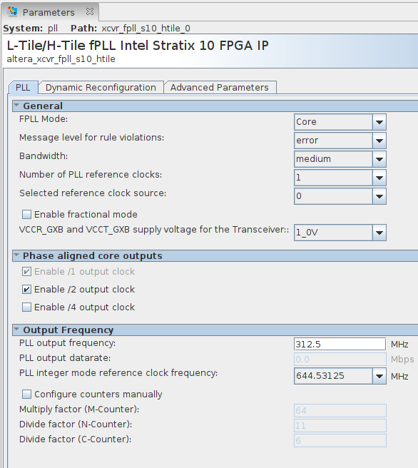

- fPLL: ref_clk =644.5312 MHz. outclk_div1 = 312.5 MHz, outclk_div2 = 156.25 MHz

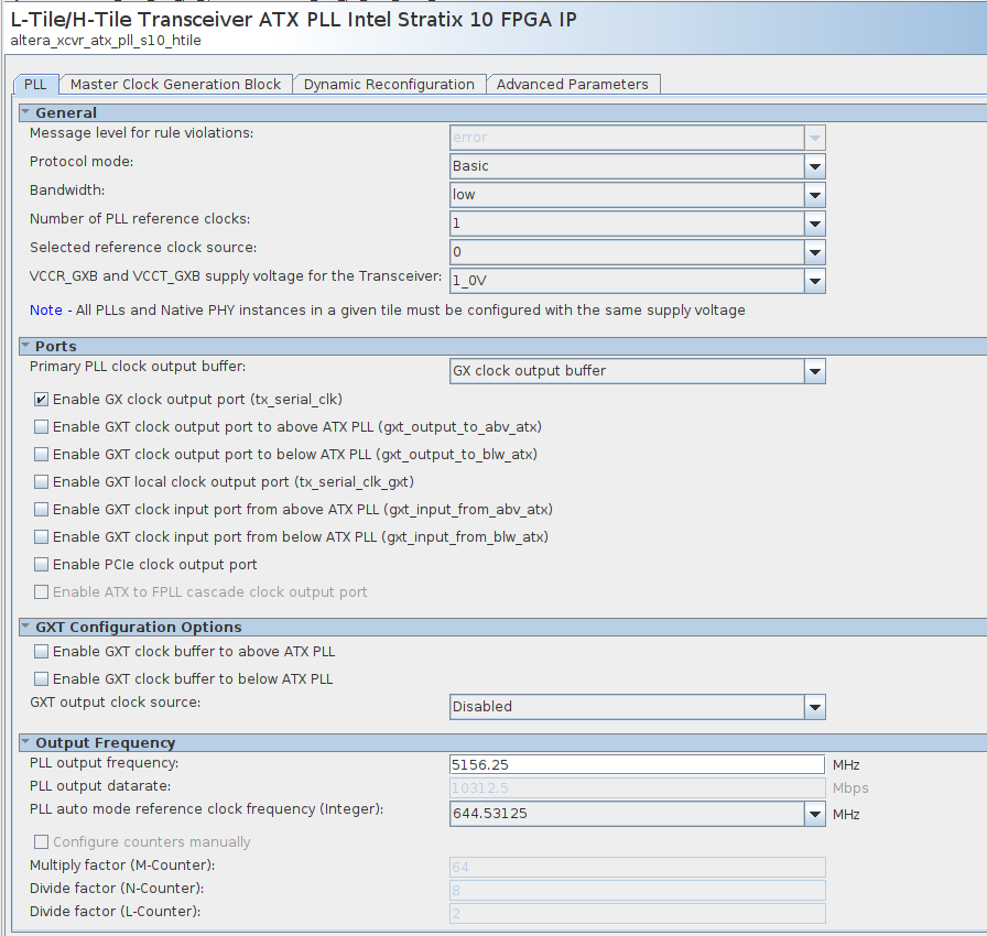

- ATX PLL: ref_clk = 644.5312 MHz
- PHY: rx_cdr_refclk0 = 644.5312 MHz
4) Change csr_clk to either 100 or 125 MHz. Then reconfigure Reset Synchronizer: ref_clk = 100 or 125 MHz.

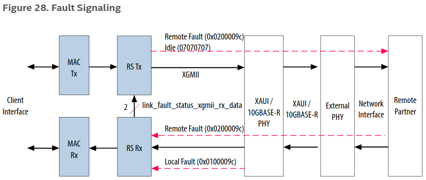

- QSFP Port 0: All 4 channels got local faults
- QSFP Port 1: channel 0 passed (both TX and RX are Idle). Channel 1, 2, 3 got local faults

The Intel S10MX board only provide QSFP reference clock of 644.5312 MHz. That's why I modified the ref_clk settings in the PHY, ATX, and fPLL module to 644 MHz.PHY setting: modifychange CDR reference clock
ATX PLL setting: modify PLL auto mode reference clock
altera_xcvr_atx_pll_ip atx_pll_inst( .pll_refclk0(ref_clk_clk), .tx_serial_clk(tx_serial_clk), .pll_locked(atx_pll_locked) );fPLL setting: modify PLL integer mode reference clock
pll fpll_inst ( .pll_refclk0 (ref_clk_clk), .pll_cal_busy (), .outclk_div2 (core_clk_156), // 156.25MHz clock .outclk_div1 (core_clk_312), // 312.50MHz clock .pll_locked (core_pll_locked) );Top-level file
