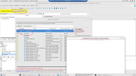

6 years agoWhich part of design example eth_e2e_e10 based on platform designer
Hello Sir?Madam I am running the eth_e2e_e10 design example now. I have a IP upgrading issue now . When I open the Quartus pro GUI in linux, and open the dcd.qpf project , system reminder to u...
MEIYAN_L_Intel
6 years agoHi,
I had build the design example and I am able to open the platform designer to upgrade the IP component.
As mentioned earlier, the platform designer is hang on initializing page, you may need to follow the instruction as below:
https://www.intel.com/content/www/us/en/programmable/support/support-resources/knowledge-base/tools/2017/why-does-qsys-pro-hang-at-initializing-qsysipc-bridge.html
