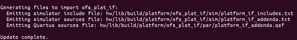

The operating platform is intel arra10, and there is an error in the process of upgrading fim to pim.
Obtain the upgrade information from https://github.com/OPAE/ofs-platform-afu-bbb/tree/master/plat_if_release/templates/ofs_plat_if_compat/a10_gx_pac_ias, and successfully generate a new platform in hw after running install.sh document.

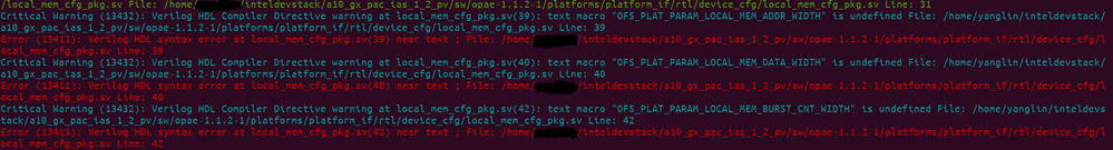

But when I start compiling PR there is a compatibility error, the error is as follows:
Critical Warning (13432): Verilog HDL Compiler Directive warning at local_mem_cfg_pkg.sv(39): text macro "OFS_PLAT_PARAM_LOCAL_MEM_ADDR_WIDTH" is undefined File: /inteldevstack/a10_gx_pac_ias_1_2_pv/sw/opae-1.1.2-1/platforms/platform_if/rtl/device_cfg/local_mem_cfg_pkg.sv Line: 39
Error (13411): Verilog HDL syntax error at local_mem_cfg_pkg.sv(39) near text ; File: /inteldevstack/a10_gx_pac_ias_1_2_pv/sw/opae-1.1.2-1/platforms/platform_if/rtl/device_cfg/local_mem_cfg_pkg.sv Line: 39
Critical Warning (13432): Verilog HDL Compiler Directive warning at local_mem_cfg_pkg.sv(40): text macro "OFS_PLAT_PARAM_LOCAL_MEM_DATA_WIDTH" is undefined File: /inteldevstack/a10_gx_pac_ias_1_2_pv/sw/opae-1.1.2-1/platforms/platform_if/rtl/device_cfg/local_mem_cfg_pkg.sv Line: 40
Error (13411): Verilog HDL syntax error at local_mem_cfg_pkg.sv(40) near text ; File: /inteldevstack/a10_gx_pac_ias_1_2_pv/sw/opae-1.1.2-1/platforms/platform_if/rtl/device_cfg/local_mem_cfg_pkg.sv Line: 40
Critical Warning (13432): Verilog HDL Compiler Directive warning at local_mem_cfg_pkg.sv(42): text macro "OFS_PLAT_PARAM_LOCAL_MEM_BURST_CNT_WIDTH" is undefined File: /inteldevstack/a10_gx_pac_ias_1_2_pv/sw/opae-1.1.2-1/platforms/platform_if/rtl/device_cfg/local_mem_cfg_pkg.sv Line: 42
Error (13411): Verilog HDL syntax error at local_mem_cfg_pkg.sv(42) near text ; File: /inteldevstack/a10_gx_pac_ias_1_2_pv/sw/opae-1.1.2-1/platforms/platform_if/rtl/device_cfg/local_mem_cfg_pkg.sv Line: 42
Are there any other steps that need to be done? Or there are more detailed guidance documents
