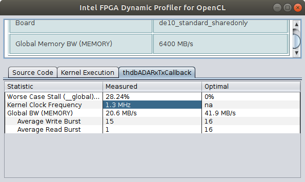

However, the kernel is extremely slow. The Dynamic Profiler shows that the kernel clock runs at 1.3MHz. How can I investigate what slows down the Kernel clock to such a low frequency, what are best practices to increase the kernel clock frequency?
See the attached screenshot for details
Profiling Results:

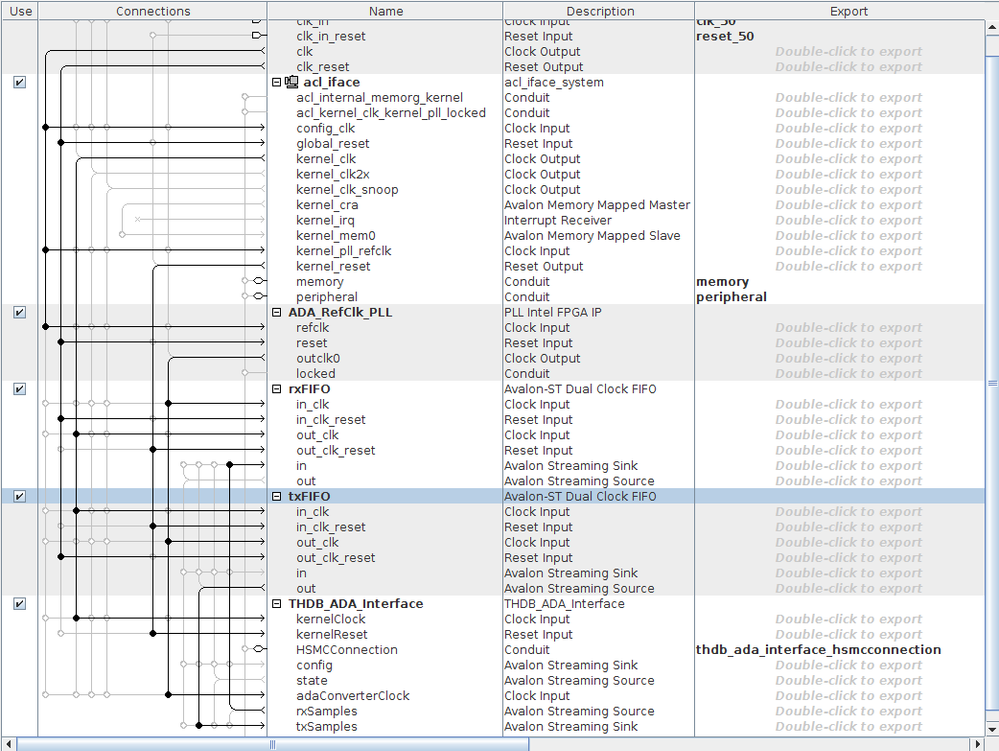

The Qsys System:
