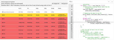

We are using `char` for now. Actually, in our case we are just utilizing around 23% of all the DSPs.
Then you could be running into this [age-old] bug:
https://forums.intel.com/s/question/0D50P00003yyTf2SAE/how-to-share-dsp-correctly-?language=en_US
Essentially, the compiler claims it is packing multiple low-precision operations into one DSP, but in fact it is not and hence, internally, DSP over-utilization is detected and extra operations are mapped to logic, while the report does not reflect the DSP over-utilization. You might have better luck using the arbitrary precision integer extension, rather than using the char data type.
