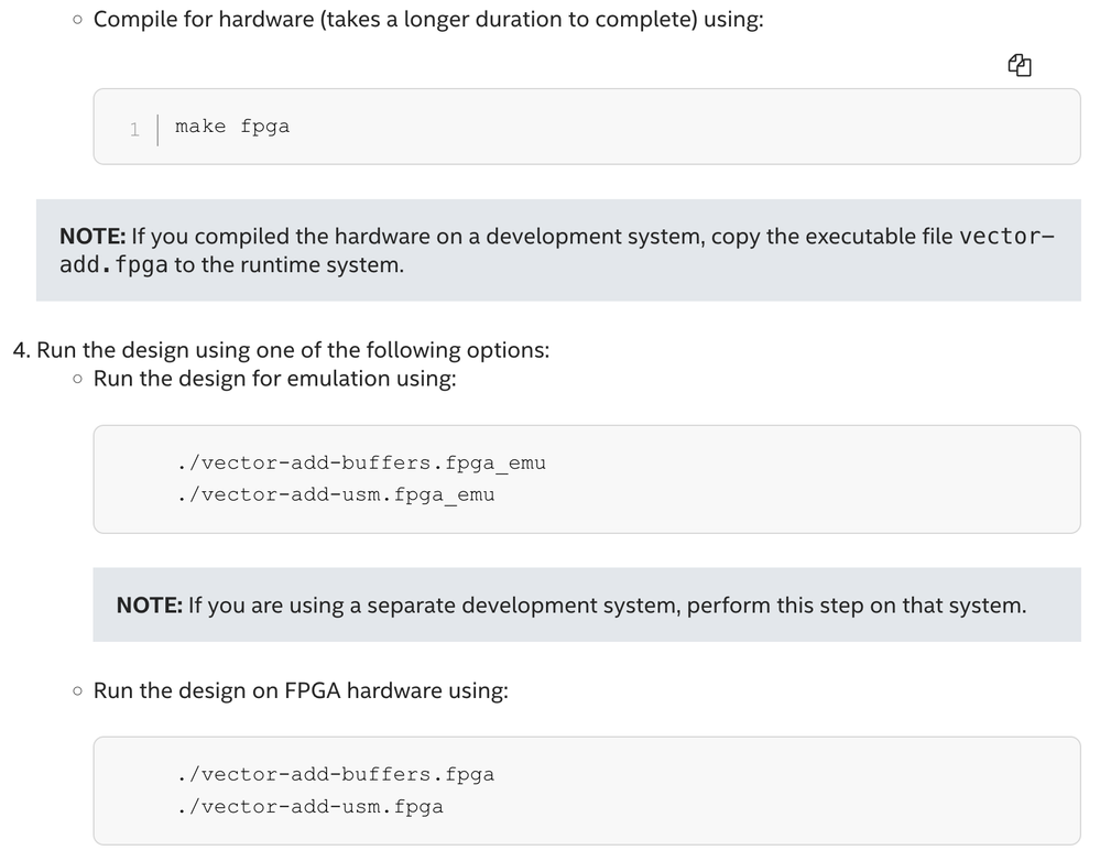

I just started with oneAPI tutorial for setting up the basic workflow, and the design that I am using is the vector-add sample (seems to be FPGA SYCL code). I want to try 'make fpga' step in Get Started with the Intel® oneAPI Base Toolkit for Linux* which is similar to the tutorial you shared. It suggests me to copy the executable file to the runtime system, and run the executable file.
By mentioning "we only support x86 machine as host (linux or windows) not the HPS core on our SoC FPGA", does it mean I need to run './vector-add-usm.fpga' on my x86 machine as host, and the FPGA will be programmed automatically?

- It suggests me to copy the executable file to the runtime system, and run the executable file.
The "runtime system" referring to the computer that the FPGA Card is connected to, either through PCI-E or USB. We mention copying here because it is common to use different machine to compile and run the executable.
- does it mean I need to run './vector-add-usm.fpga' on my x86 machine as host, and the FPGA will be programmed automatically?
Yes. Assuming you have the FPGA card connected and initialized, and proper driver and BSP/ASP installed. If not, I am linking some resources for how to do that:
- You need to install the oneapi base toolkit and the oneapi fpga support package. You also need to have Quartus installed.
- You need to install the Accelerator Support Package (ASP) for your specific board. You can usually get the ASP from your board vendor, or it can be generated by following this guide: https://ofs.github.io/ofs-2024.2-1/hw/common/user_guides/oneapi_asp/ug_oneapi_asp/
- You need to initialize your board: https://www.intel.com/content/www/us/en/docs/oneapi-fpga-add-on/developer-guide/2024-2/managing-an-fpga-board.html
Once the above is settled up, you can then run the executable such as "vector-add-buffers.fpga" same why you run any binary executable.
