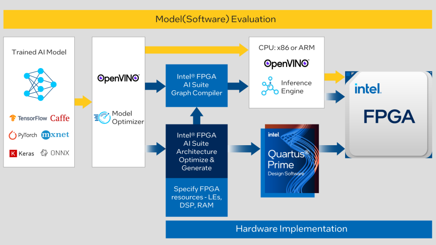

Hi everyone, I'm planning to implement a CNN model on Intel SoC FPGAs and I have some questions below:
1. Which toolkits are required for implementing AI models on Soc FPGA? I know about OpenVINO and FPGA AI Suite but do I have to use both?
2. Which Soc FPGA development Kits are supported now?
Thanks for your time.

Devices supported to use Intel FPGA AI Suite are:
- Intel Agilex® 7 FPGA
- Intel® Cyclone® 10 GX FPGA
- Intel® Arria® 10 FPGA
You may refer here for further info.
You could choose any of them and here is the guide to get started.

- For this inquiries, it is best to contact the FPGA team, which you may proceed here
- Looking at the documentation that I shared before, you should be able to use it since it is enabled by Intel FPGA AI suite.
3. I'll clarify these and will get back to you asap
Cordially,
Iffa
- JohnT_Altera
For license queries, you will need to contact your local sales team. You can get the contact from https://www.intel.com/content/www/us/en/software/programmable/fpga-ai-suite/overview.html.
