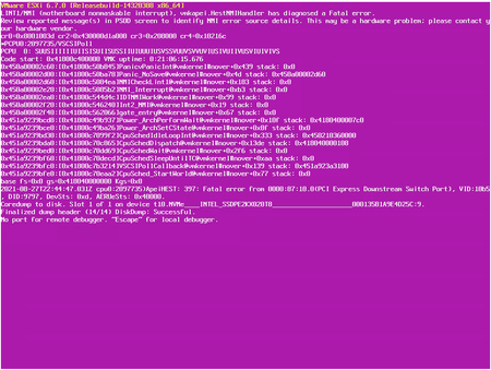

Server crashing (PSOD) upon running fpga_dma_test
The source of your problem is very likely VMWare. Intel does not claim they support VMWare ESXi for their FPGA boards anywhere in their documentation. The only reference I can find is from VMWare's own blog:
https://blogs.vmware.com/vsphere/2020/01/vsphere-support-for-intel-fpga.html
The blog post claims support for the A10 PAC (and not the S10 PAC you are using) in ESXi 6.7 Update 1 (you seem to be using 6.7.0?). If you really want to use the board with ESXi, then you should probably reach out to VMWare. On the other hand, if you want to save yourself the headache of spending days or weeks just getting the board to work, your best bet would be to drop VMWare and just use the board in a non-virtualized environment. Docker could also be an option if that type of virtualization works for you.
