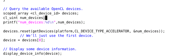

- Titanameda6 years ago
This is what I have !
