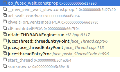

    For your information, I managed to get a call stack from when the queue hangs, maybe this helps people with insight into the closed sources
