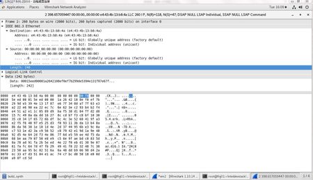

Hello Sir/madam, For design example eth_e2e_e10, 1,May I know where I can check the c code or SV code for 10G mac configuration in design example eth_e2e_e10? 2,As to CRC checksum, I have noticed ...
