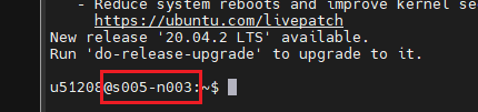

  • Hi @JInxuanBen,
    Possible to share what are the nodes that you run to command on so that I can get the platform team to check on it?
    Node# can be found when you are connected as below:
    Best Wishes
    BB
