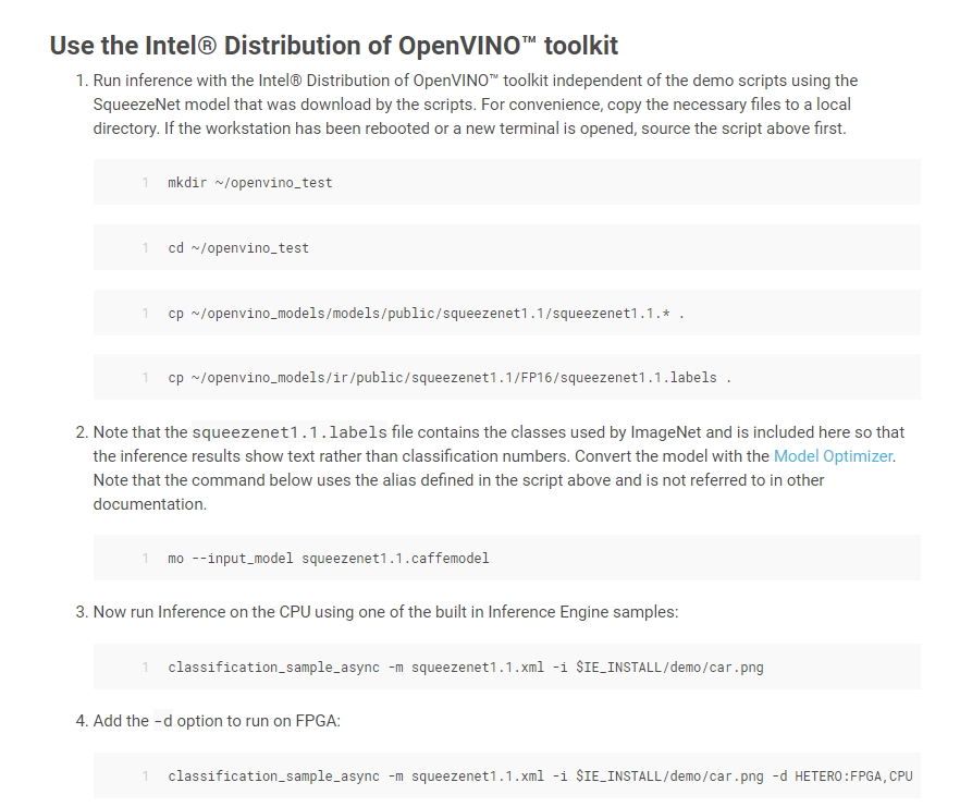

My goal is to run deep learning inference targeting `HETERO:FPGA,CPU`, is the N3000 PAC capable of doing this?
Another question, how do I run `aocl diagnose` on the N3000 pac? And, if I installed only N3000 Acceleration Stack, `sudo fpgainfo fme` is not working as well.
