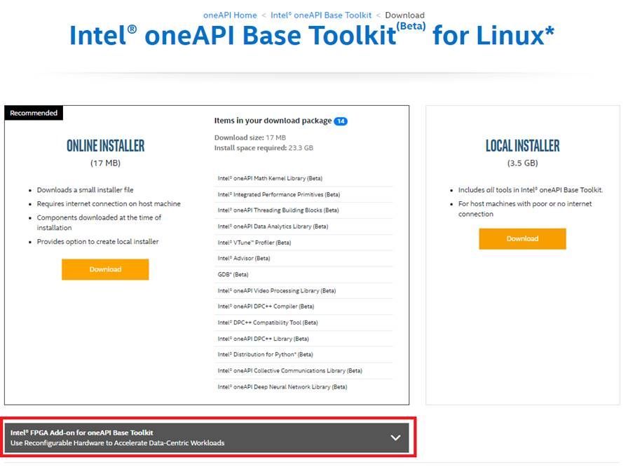

- antarde_intel6 years ago
Hi ,
For running "make fpga" you need to install the FPGA add-on. If you dont have it installed, please follow the steps below.
If you go to the bottom of the download screen for the Base toolkit, the FPGA addon can be downloaded if you expand the bottom box (in red). You might need to redownload/install the Base as well, if you are using an older Beta version and we’re on Beta08 right now
From https://dynamicinstaller.intel.com/oneapi/toolkits/base-kit/linux/:
