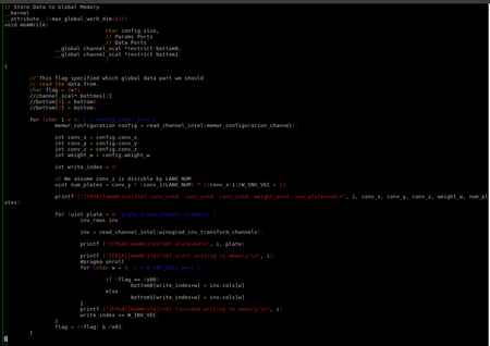

7 years agoKernel stop right at the "printf" command.
I have design which behaves weird in one specific situation, and stops progressing, which I don't know the reason. In this design I have added "printfs" to the non-autorun kernels to track the behav...
HRZ
7 years agoHave you checked the beginning of the log to see how it starts? The compiler might have reordered your printfs. Printf output is dumped after kernel execution, which means your kernel must have executed all the code and exited if you are getting printf output.
