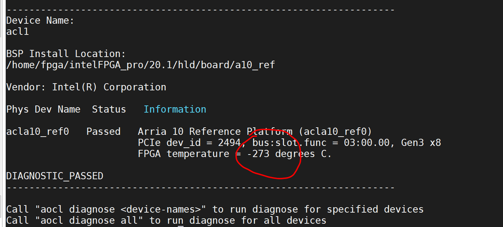

Incorrect temperature read for a10_ref BSP of v20.1
I have recently upgraded the BSP of a10_ref board to version 20.1. And the aocl diagnose command could not correctly read the temperature now as follow. How can I fix this issue ?

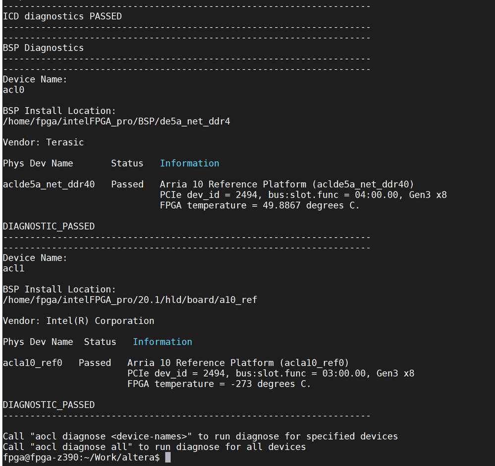

      (1) I have two a10 boards installed on my workstation, the other one is Teraisc's DE5a-net-ddr4, which works fine after the upgrade, Please see the diagnose result as follow:
