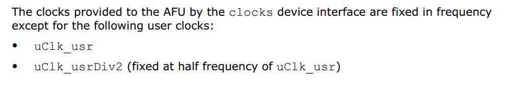

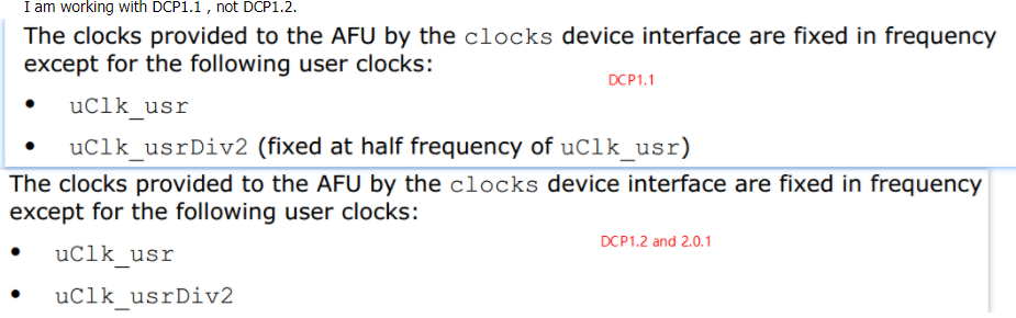

- HYl
I am working with DCP 1.1, not 1.2 or 2.0.1
So this guide is not suitable for me.

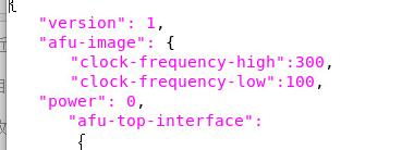

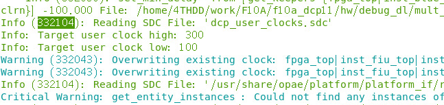

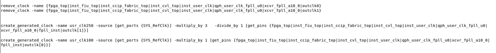

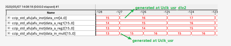

Please read the pictures in my attachment.
