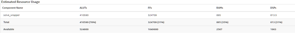

I tried to compile design for two Stratix V devices: 5SGXEA7K2F40C2
and 5SGXEABK2H40C2. And the result is the same even though these devices have different parameters. And actually the design always compiles for 5SGSD8 as I see from available resources. How can I fix it?
