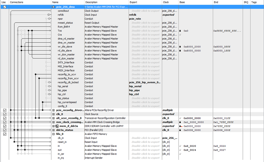

Since I still don't fully understand how the whole PCIE/DMA/AVALON system works, I would really appreciate input on how to connect a FIFO to this system on the Platform designer.
I tried connecting the read master of the PCIE to the out of the fifo, and the write master of the PCIE(v-series mm dma for pci express) to the in of the fifo but I got the following errors:

Connecting them the other way around was accepted(I left the
in_csr and in_irq pins dangling because I don'know what to do with them) but that didn't work.
I will be adding a screenshot of the platform designer as soon as I can .

This is not relevant to my question. This is using the stratix hard ip for pci express. The reference design my question is about uses the v-series mm dma for pci express and therefore has completely different connections. I already have a PCIE system, I just want to connect a FIFO to it, not start over with another reference design that also has no explicit mention of FIFOs. Here is the screenshot of my system:

I have managed to communicate with the fifo using PCIE_Write32/Read32() and was experimenting with Dma_Write(), which worked, and Dma_Read(), which didn't work.
I don't need further assistance with connecting the FIFO in the platform designer. It seems the configuration I posted in the screenshot does work. I will be posting an answer to my own question soon for others who might face the same confusions as I did.
