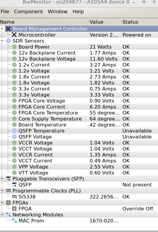

Going over the manual leads to solution of adding 3 USB fan to back of my workstation, it reduced the 3 intake fan speed to 20% which quiet it down to acceptable level ( I am deaf on one side so very sensitive to noise). FPGA core temperature level off at 55 c. Not perfect, good enough for now.
