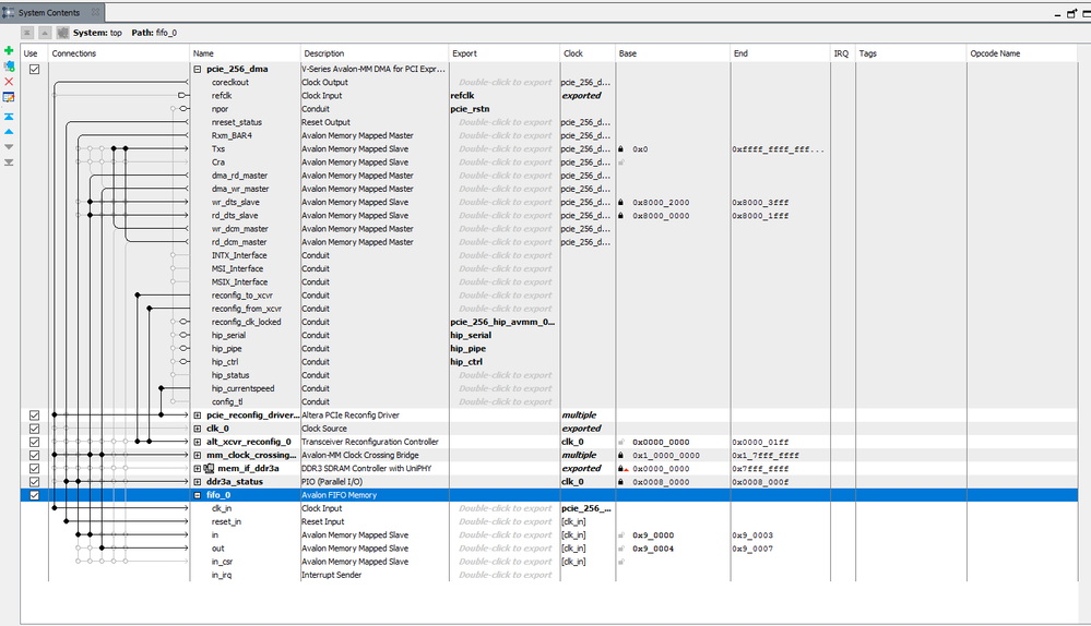

I am trying to transfer data between a PC and an FPGA. I am using C++ for the computer program and the FPGA is a Stratix V. On the FPGA, I need to use FIFOs to buffer recieved data and data about to be sent.On the FPGA I am using a PCIE example design from the user CD of the DE5-net kit.
I have managed to write to- and read from- an on chip fifo using PCIE_Write32() and PCIE_Read32(). The user Manual states, however, that these functions are not appropriate for continuous, large data transfers and that PCIE_DmaRead()/PCIE_DmaWrite() should be used instead.
I tried Writing data to the FIFO using PCIE_DmaWrite() and it worked, as I verified by reading the written values with PCIE_Read32(). My problem is that I cannot get PCIE_DmaRead() to work. Whenever I call it it returns a random(but fixed) value, and does not pop anything from the FIFO(doesn't reduce the fill level).
am I doing something wrong or is it only possible to write to, but not read from, FIFOs by using the DMA functions?
here are my code and my design:

  • Hi Sir,
    Theoretically, DMA function is not work for FIFOs but it is only work for memory that have physical address. FIFO unlike a memory (DDR3) and no address associate with it. Thus, for FIFO, we usually used write/read32.
1 Reply
  • BoonT_Intel's avatar
    BoonT_Intel
    Hi Sir,
