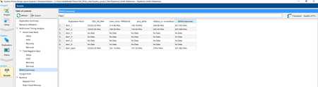

6 years agoHow can I use a specific compilation/exploration point from DSEII for my actual project?
After running DSEII, I don't know how to manipulate the results I get. How can I apply one of the compilations to my project to generate an .sof file, or how do I save the exploration points to use t...
sstrell
6 years agoIt depends on your settings in the Exploration settings (Select results to save). You can choose to generate Quartus archive files (.qar) and .sof programming files. The generated reports will tell you what settings were used. Creating a .qar is probably the easiest because it includes everything.
#iwork4intel
- SAbde76 years ago
Yes but how do i access those files?
