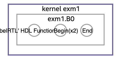

How can I generate a library from HLS to be used in OpenCL, without fpga_crossgen due the use of system of task?
I have a design implemented with system of task in HLS and I want to use it with OpenCL. I wrote the .xml that uses the files in folders: /components and /ip for "REQUIREMENTS" and the "design_internal.v" as the name of the "module". With this, .aoclib was generated and linked to a Opencl code. I am compiling to check the report using:
aoc -rtl -v -l opencl_lib.aoclib exm1.cl
The problem is that I do not see in the system viewer the logic inside the HLS design (even in the folder kernel_hld), it only shows "instruction" elements for inputs (Avalon MM):
When the design is compiled, the amount of resources used is only for dispatch. Do you have some guide about the files from HLS that I have to use to link with OpenCL? Could you give me some advice about this problem?

    May I have the design file to compile at my side for further investigation?
