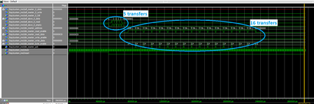

7 years agoGenerated code by Intel HLS does not work
I have the following code: hls_always_run_component void Target00(ihc::mm_master<word4_t,ihc::aspace<7>, ihc::awidth<32>, ihc::dwidth<32>, ihc::latency<0>, ihc::waitrequest<true> >& device_5, ihc::...
- 7 years ago
The problem was with the avalon_mm_adapter. @HGuer2 will confirm that the message I sent him fixes the issue.
