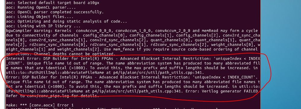

Hi, I have encountered the follow error while using OpenCL SDK v18.1.0 with a10_ref board:
It seems that it has something to do with file naming, the message has not been included in the user's manual. Software simulation works fine.
Problem solved. Shortened the name of the kernel from 10 characters to 6.

Hi, Are you trying to compile any of the example provided with OpenCL compiler release ? or you are compiling your custom Kernel ? Internal Error is most probably due to a issue in compiler. Thanks, Arslan - DongWang-BJTU
