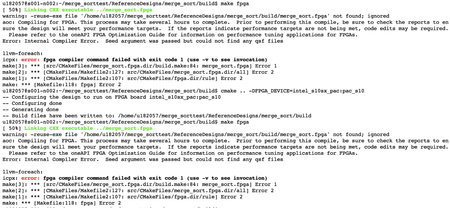

Failed when compile oneAPI-samples/DirectProgramming/C++SYCL_FPGA/merge_sort on FPGA hardware

Just to ensure that you are running the example in the right platform jupyter mention I believe its in Intel DevCloud.
Sometimes in jupyter you will be assigned by the node that are not having the right resources.
Hence would recommended the following:
1) Perhap you can access different node in jupyter by following the steps 'New Batch Mode Tutorials' in the link (https://devcloud.intel.com/oneapi/documentation/shell-commands/)
2) Accessing the devcloud via ssh which will give you more options to select the desire node.
As for the second issues on permission, as per my knowledge there shuold not be any restriction there.
Maybe can double check on the files permission via the linux command.
Hope that clarify.
