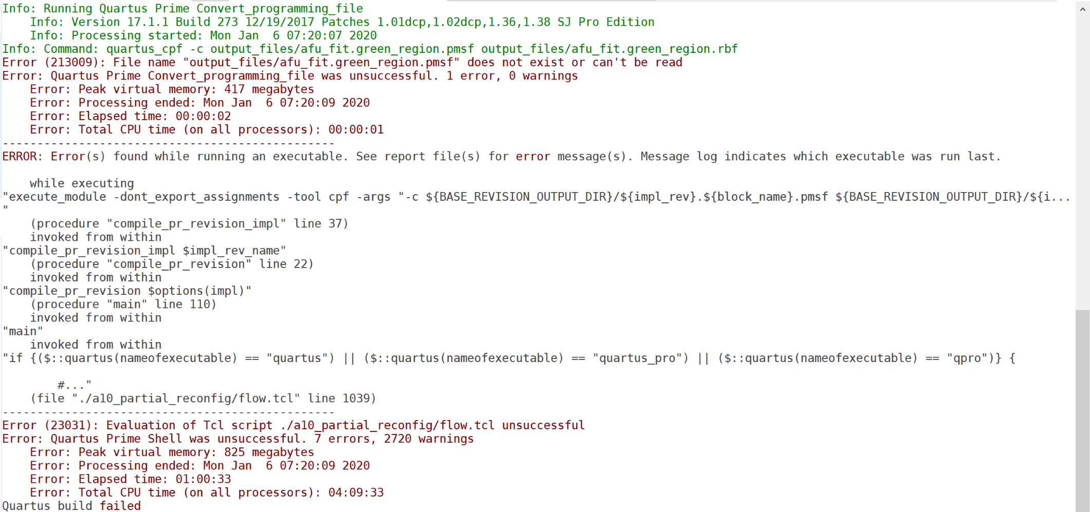

I tried to run the Minimal Flow Example from the above link. I faced the following errors(kindly find it in the attachment).
Is it possible to point to the issue based on the errors?
