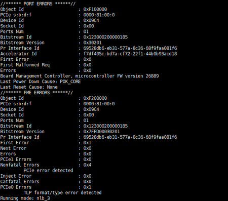

7 years agoErrors on Intel Acceleration Stack Version 1.2 with Intel Arria 10 GX FPGA
when I execute "fpgabist nlb_mode_3.gbs", error "PCIe error detected" is reported,see picture1 and 2. when I excute "fpgabist dma_afu.gbs", another error "Failed Test:fpga_dma_test" is repor...

7 years agoJust to clarify, for Arria 10 device, the Device control register is at 0x88 (0x78 is for Stratix 10 device). Therefore, the command should be sudo setpci -d 8086:094C 0x88.L
JDALO
7 years agoI have run the commandsudo setpci -d 8086:094C 0x88.L,the value is 0009283f while 7:5bit is 001b. And what can I do next to solve the errors.
