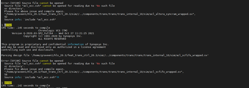

I've generated a design using HLS and is trying to simulate the design using vcs script generated by HLS in the verification directory. But it is throwing syntax errors while compiling the code.
The same codes were compiled properly using modelsim
Any tips to work around this issue will be really helpful

    Hi ,
    Please mention the error messages and provide the screenshots for us to get us a better understanding of the error.
    Also since the design is working fine , and the modelsim simulation is also working fine , this might not be related to and issue with HLS as such. You may have to look at how the vcs is setup.

  • Steps followed:
    I took the vcsmx_setup.sh script followed the steps mentioned in the script to create new top level script with my RTL files as well and tried compilation. But this is the error I'm getting
    Include files are not found for hls generated codes. There are some syntax related error as well.
    This is my top level script
