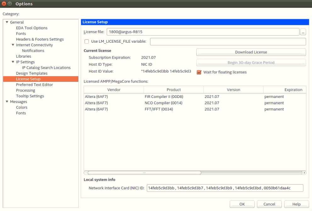

this is how my license setup looks like:
  • HRZ's avatar
    HRZ
    Your Quartus license should support "Partial Reconfiguration" for you to be able to use it with OpenCL. Contact the person/entity you purchased the license from to add "Partial Reconfiguration" support.
