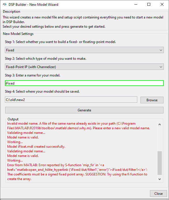

It gave this error when trying to create a fixed-point model with New Model Wizard.
- SengKok_L_Intel
I can see the same error if I use the same name to generate the model twice. Please try again by using a unique name and that is the first-time use to generate the model.
Regards -SK
- SengKok_L_Intel
If further support is needed in this thread, please post a response within 15 days. After 15 days, this thread will be transitioned to community support. The community users will be able to help you with your follow-up questions.
- User1580871742356367
I still got error with different name by selecting Fixed-Point IP (simple testbench).
However the error went away if Fixed-Point Primitive subsystem (simple testbench).
Floating ones are OK so far. Thank you.
