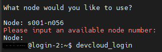

At the time being do notice that the node mention 's001-n056' are not listed as a valid node. (which might explain the device not found error)Hence can you try to select with A10 oneAPI and see if that solve the problem.
Hope to hear from you soon.Best Wishes
BB - HongboRong
Thanks for the reply, BB. You may "devcloud_login", and choose 2, 4 or 5 for any machine with oneapi, not necessarily s001-n056. They all have the same issue.
