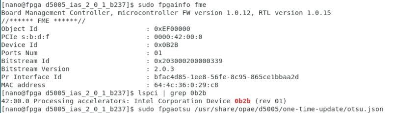

I want to updata my PAC D5005 FW&BMC to 2.0.1 ,but the info as attachment。
what should i do next

chapter 4.1.1 ,i've tried many times ,still got the same log.

i wanted to install D5005 ,but here are some problems
i referred to the ug Intel Acceleration Stack Quick Start Guide: Intel FPGA Programmable Acceleration Card D5005,link is https://www.intel.com/content/www/us/en/programmable/documentation/edj1542148561811.html#iyl1548632576241
my operations flow
1. install Acceleration Stack Version 2.0.1,updata FIM and BMC,before updating ,fpgainfo show as follow
2. refer to 4.1. updata Acceleration Stack Version 2.0, fpgainfo as blow,FW version 0.0.0 and mac address unavaible.rerun with sudo not word.
3. retry also not work

Could you try running "sudo super-rsu /usr/share/opae/d5005/super-rsu/rsu-d5005.json"? Could you provide me the full log if you are still facing issue?
