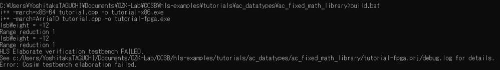

I installed Quartus Prime Pro 19.4 along with HLS Compiler and ModelSim.
I'd like to start the HLS development, so I tried to build the examples.
However, build of the example "ac_fixed_math_library" fails. First, the command prompt returns error when running build.bat : "Error: Cosim testbench elaboration failed". This is the screen image of the command prompt.

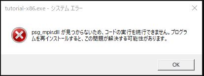

Second, the generation of tutorial-x86 seemed successful, so I tried to execute it; however it fails due to lack of psg_mpfr.dll and psg_mpir.dll. This is the error screen:
This Japanese message reads like: "Cannot continue the execution of this code because psg_mpir.dll was not found. Reinstall of the program may resolve this problem". I reinstalled HLS compiler and ModelSim, but the problem was not solved.

Hi ,
The issue seems with the ModelSim settings, as you can see a similar forum post with the similar ONERROR
https://forums.intel.com/s/question/0D50P00003yyTfPSAU/univercity-program-vwf-simulation-error
Please try the solution mentioned in the post , and let us know the results.
