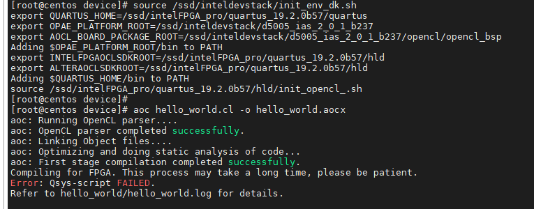

We used the user guide(Intel Acceleration Stack Quick Start Guide -- Intel FPGA Programmable Acceleration Card D5005-ug-qs-ias-d5005.pdf) and the Installation package(d5005_pac_ias_2_0_1_pv_dev_installer.tar.gz) to install the build environment.But when we completed the installation and Running the Hello FPGA Example,is reported errors.Is it any wrong during installation causing this compile error?

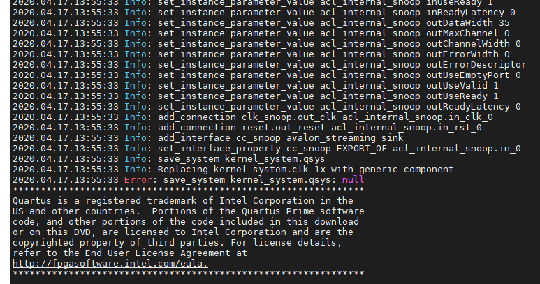

    May I have the hello_world.log file for futher investigate?

      sorry for the late update.We modified the environment variable,and the system can compile successfully.Thanks
