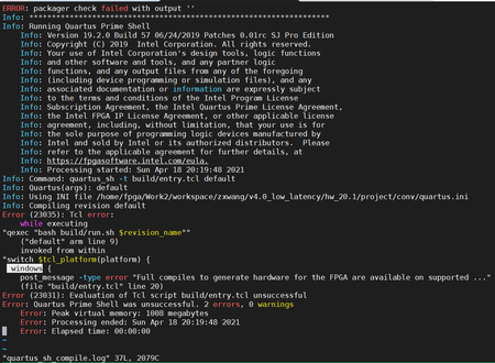

DongWang-BJTUOccasional Contributor5 years agoCompilation Error on Ubuntu 18.04 for PAC_a10 I am trying to accelerate OpenCL applications by using PAC a10 card on a Ubuntu18.04 machine. I have installed the BSP and corresponding componets form a10_gx_pac_ias_1_2_1_pv_dev.tar. No Error w...Show More
EricMunYew_C_IntelFrequent Contributor4 years agoCan you refer to below KDB:https://www.intel.com/content/www/us/en/programmable/support/support-resources/knowledge-base/embedded/2019/error--packager-tool-failed-to-run.html
