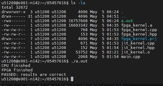

  • Hi @raulhs,
    Thank you for posting in Intel community forum and hope all is well.
    I have tried to compile the provided code on the mention node and are able to completed as below:
    The steps that I have used to completed are following the section 'FPGA Hardware Compile' for linux.
    Hence my guess there might be some platform inconsistencies during your compilation or some missing steps, would suggest to check on them.
    Hope that clarify.
    Best Wishes
    BB
