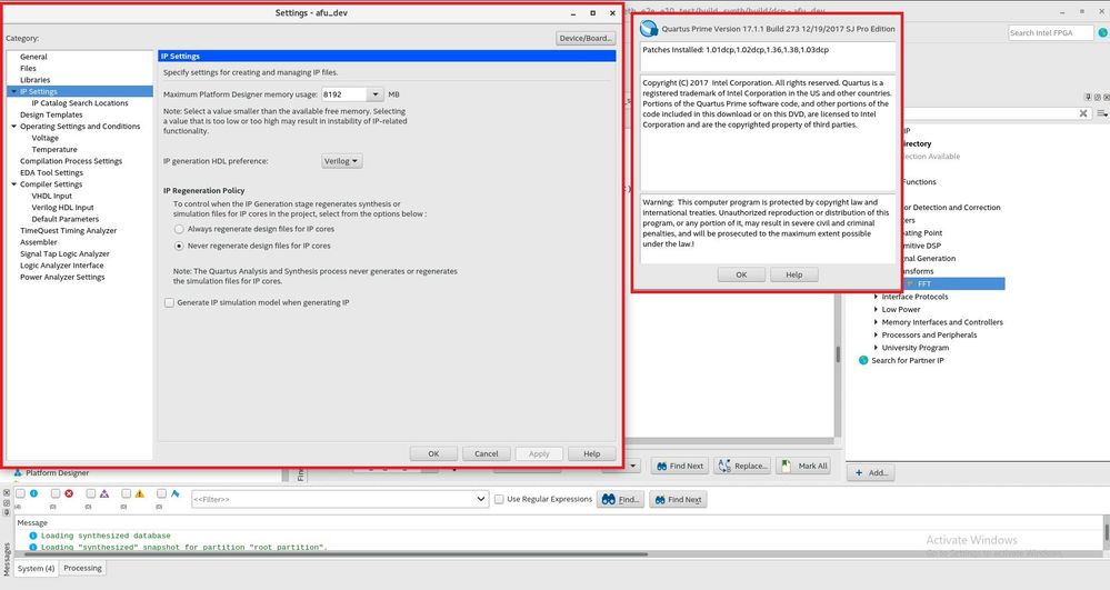

I am using Intel PAC arria10gx, OPAE was installed on linux centos7 successfully , and I have done some development based on current environment including signaltap2 and ethernet application.
The problem is I still can NOT open the platform designer to install any IP core or edit any existing qsys based design module.
it is just like below, it hang without any response.
I have changed my memory usage from default to 8192 or 16384MB, both of settings can NOT solve the issue.
