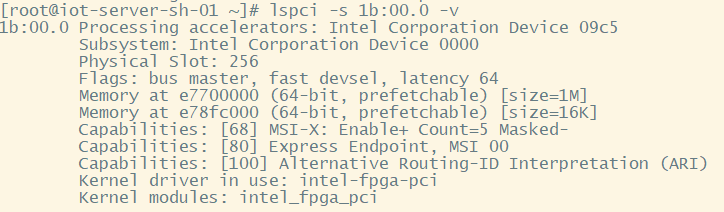

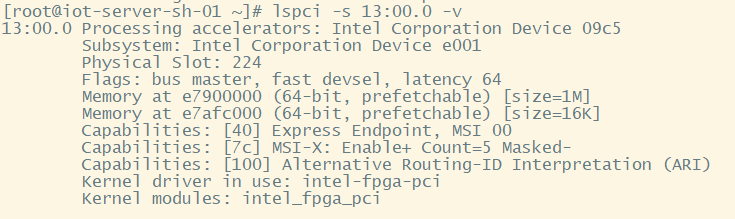

The output log after I use "lspci -s 13:00.0 -v" and "lspci -s 1b:00.0" command is:
As you can see, the two cards has same device name 09c5. What do these two logs represent? Did the pci port "1b"00.0" and "13:00.0" detect two different acceleration cards?

Hi.
Both is using the same driver. It is just enumerated with different PCIe bus address as this is 2 different Physical Function.
